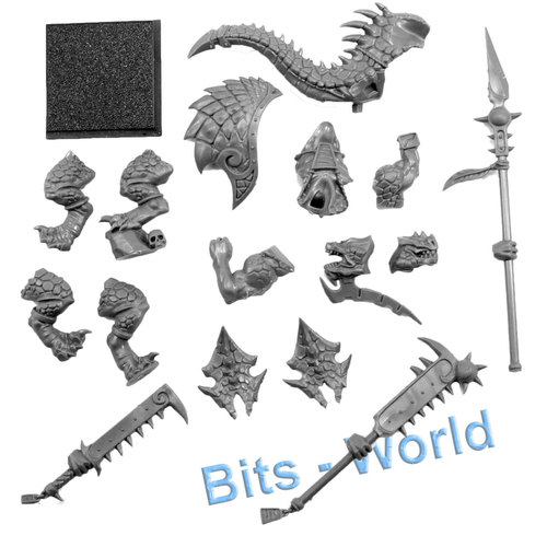

    Ok I will go first, I'd like to do dark elf cold one with old blood and maybe some others, which kits would you use for the rider?
  3. Rikard
    Bastiladon
    Rikard Well-Known Member
    758
    707
    Hmm, much of that comes down to personal preference.
    However, for ease of converting I'd make use of plastic or fine cast (yes...even finecast) over metal, it's easier and quicker to cut and shape.
    I'd first off take the saddle from the plastic cold ones, you could even spend a bit more cash by stalking the ebay auctions to pick up the scar vet on cold one with the skaven saddle.
    Next I'd use the carno lord, you've got numerous bits you can cut and shape to fit on a saddle for the cold one, this includes the legs (I'd go so far as to stick the legs on the saddle first, before attaching them to the body). It will be easier to fill in the gaps between the legs and body with the green stuff, rather than try to fit the body around the saddle.

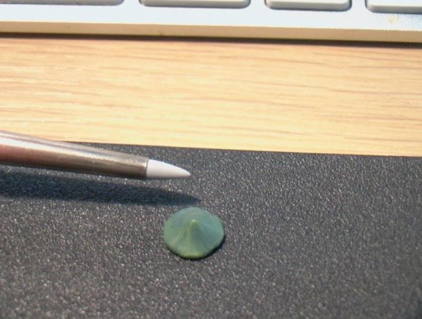

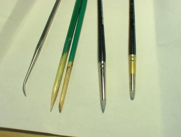

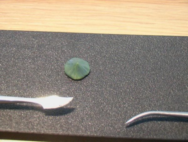

    Ok then,
    I've reposted some of the photos from the sticky in the LM discussion thread.
    The good news is you really don't need many tools at all and all of them are cheap and easy to get hold of or even make.
    A brief run down is as follows, although now I come to type it, it's a little harder than I thought for trying to describe what each does.
    Specific tools include:
    • Wax 5 (small) in the very last photo on the left hand side, next to the scale I've sculpted.
    • Clay shapers (bullet and flat tip, always get the grey, or "firm" ones in size 0, they do pick up scratches and wear with time, so keep and eye on them).

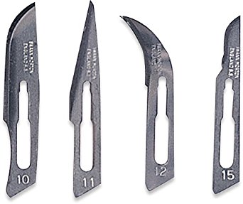

    • Scalpel (not pictured), just a normal scalpel, the ones GW does will do just fine, though cheaper ones do exist, like clay shapers the blades wear out, some textures are best with a sharp blade other with a blunt one, but you can buy blade packets by the hundred online very cheaply.
    • Scalpel (No 15 blade), quite nice for hair, but thicker blade variations, or blunt No 15 blades produce a better result.
    • [​IMG]

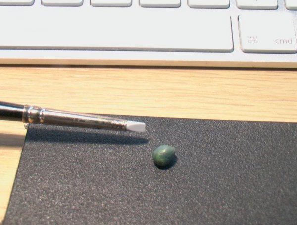

    • Old paint brushes, been using these less than two years now, but discovered them when I made the two hand weapon lizardman for Felix, these are AMAZING tools as you can shape and style them how you like with sand paper and a little varnish (they work best as pointy tools).
    Some people don't like the sticky quality of GS, but I do, part of it involves knowing how to use it and this is where the actual material of the tool comes in.
    • WOOD based tools: best for spikes, rough textures, warmer room temps (green stuff becomes more sticky), more blue than yellow in the mix, wrinkles, rubbing across different green stuff areas to hide joins and thin areas like eye sockets.
    • METAL based tools: best when the GS is either harder, colder room temps (green stuff becomes less sticky), more yellow than blue in the mix, fine edges, fine detail, areas where a stronger indentation or mark is needed. NOTE: This applies, especially if the blade is sharp, avoid dragging it through the green stuff as it will pull and warp the material on either side of it.
    • SILICON based tools (Clay shapers): The very reason you don't hear me complain about the stickiness of green stuff, if you need large areas smoothed out (especially on things like armour), then a flat clay shaper will do the job with ease. If the temperature is hot and you've mixed too much yellow in that it DOES sticky to the shaper, simply put the GS to the side for 20 minutes then try again (and repeat if it keeps happening).

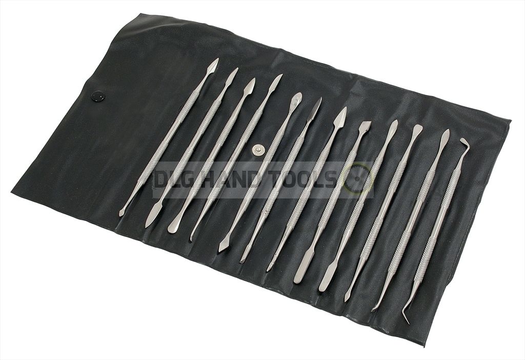

    As for Tool kits, a standard ebay kit will have pretty much everything you will need that you can't make. I have noticed though, that only dental tools have duel curved tool in the very last photo at the bottom on the right hand side (next to the wax five).
    Along with this, if you have a good file (I work as an apprentice electrician, the large files you get from wholesalers are excellent) you can actually adapt the heads of tools you don't use to make something more suitable, it's quite quick and easy too.
    FLAT tools: smoothing out areas.
    POINTY tools: Making pock marks (areas for sliding in teeth).
    EDGED tools: Adding groves, lines of detail, etc.

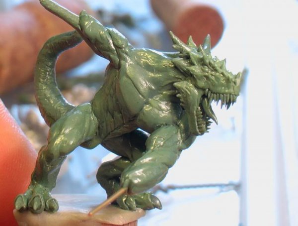

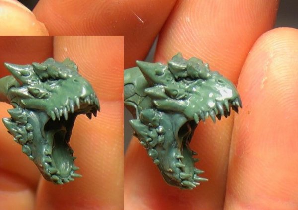

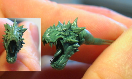

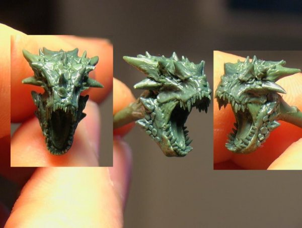

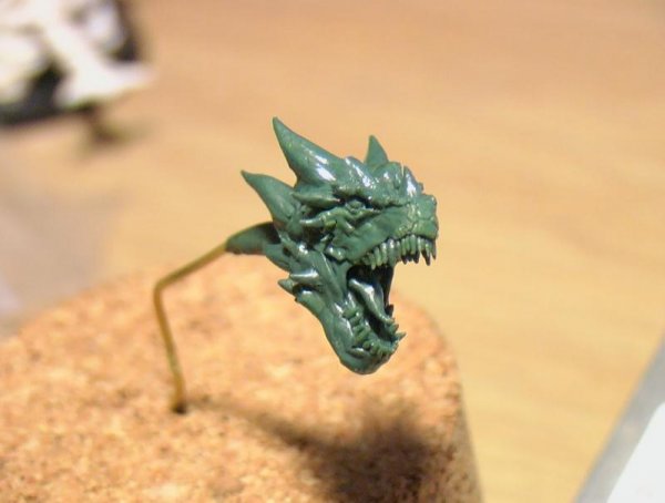

    I can't claim full credit for that, I got the idea after a chat with a hideously good sculptor called Tim Miller, he uses wax and tends to do 6-12 inch figures, but he is phenomenally good and possibly far more blunt and sarcastic then me. ;)
    Wood tools are a nice way of making use of old paint brushes and their ability to use the stickiness of green stuff to full effect is what makes them so good.
    I personally think the best LM faces I've done to date have been with wooden tools.
    Non-wooden tool use.
    Wooden tool use.
    The biggest irony here being that the heads made with the help of wooden tools are actually smaller than the ones made without them.

    Wow... all your stuff is fantastic. But I think you are right that the heads made with the wooden tools are the best of the bunch.
    So what type of wooden tool heads do you find must useful. All sharpened to points? Or are other shapes useful too, similar to metal tools?
