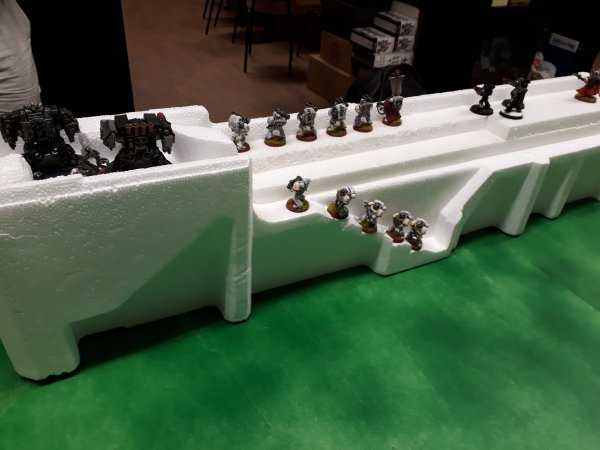

    in the last days, I've worked on a massive construction for 40k, which i intend to use in Apocalypse games, or even in standard games but with particular rules.
    It's basically the walls of a fortress (if you have ever seen Boylan's Helsreach, you know what I'm talking about), built with various polystirene material (TV packaging, polystirene foams cut, polystirene food trays…).
    2 section, each wall is 46" long.
    The question is: how do i paint them?
    I've had in mind heavy use of spray concrete grey, then brush darker grey for details and some dark green for the upper parts (parapets and similar).
    However i've never painted polystirene, so i don't know how to proceed.
    I've heard advices that direct use of spray is problematic at best and the result would be unsatisfying for a number of reasons.
    So the suggestion to bypass the problem(s) is: create a soft paste with vinyl glue mixed with water and chalk / plaster, then place it all over the surfaces, to give:
    more weight to the terrain
    more resistance to polystirene
    a paintable / sprayable surface
    but i'm here to hear also YOUR advices… ;)

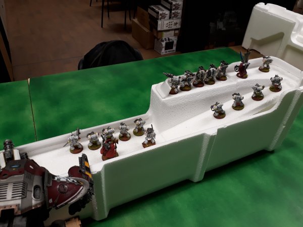

  2. Killer Angel
    15,022
    33,051
    FORTRESS WALL N. 1

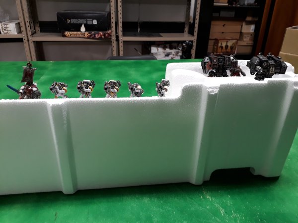

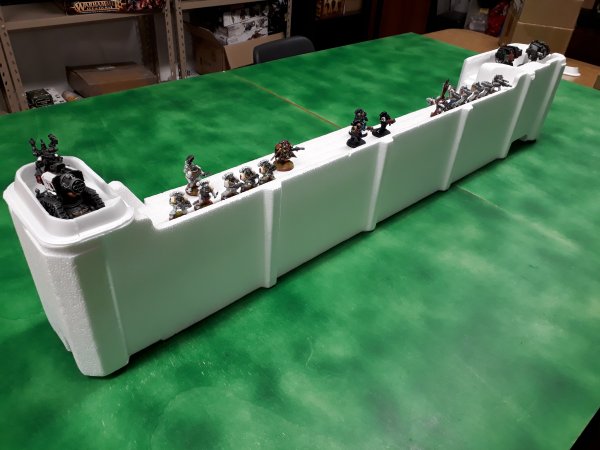

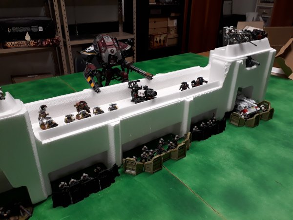

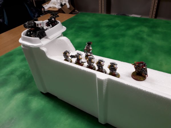

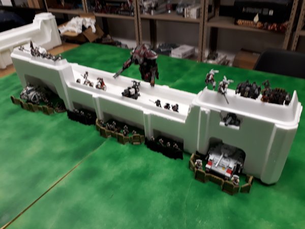

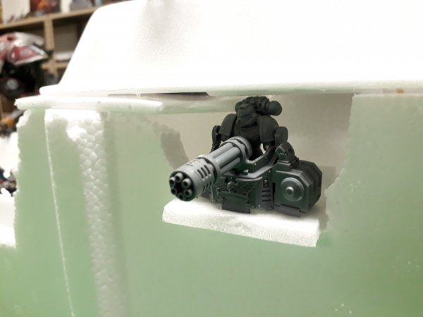

  3. Killer Angel
    15,022
    33,051
    FORTRESS WALL N. 2
    Fortezza 2a.jpg Fortezza 2b.jpg Fortezza 2c.jpg Fortezza 2d.jpg Fortezza 2e.jpg

  16. Warden
    6,464
    18,256
    Be careful with spray paint... depending on what kind you use, the spray paint will literally "melt" the Styrofoam. Test a small area first if you don't basecoat it with something first; but I would recommend giving it a regular-old coat of black/PVA layer first to seal in the little foam gubbins. Although some battle damage wouldn't be a bad idea either...
    It also makes me pleased to see the knight can literally look over the wall; almost like he is a titan...
    Aginor and Killer Angel like this.
  17. Killer Angel
    15,022
    33,051
    Yes, it was my intention since the beginning: a solid backup for the defenders. :D
    The knight needs a small platform to be raised to the needed level, but the result is threatening

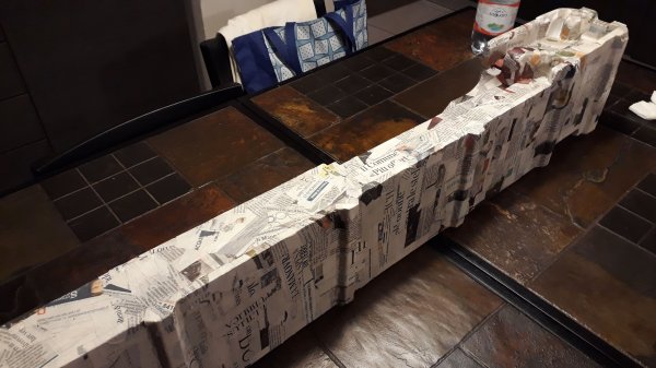

    In the end i have decided to do a test on the first one with PVA, water and paper.
    The next step could be the placing of some thick paint..
    Aginor and Imrahil like this.

    I was going to suggest covering it in a paper-maché mix - good job! gotta love TV packaging for terrain!
    Killer Angel likes this.
