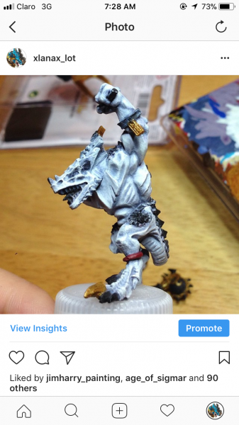

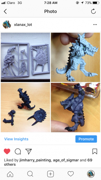

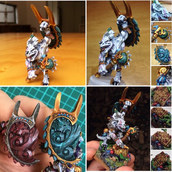

  8. Xlanax_lot
    Xlanax_lot Well-Known Member
    602
    1,646
    Hahaha thanks a lot man but I just copied gw color scheme
    Agree, here ir how I did it
    A ehile back when I was getting back into the hobby I tried to replicate gw color scheme, this is ehat i did.
    I primed black and basecoated dark purple.
    Than I continue by blending whites Up to the point where I was happy with it.
    Finally I just finished the details, you can see some more tips on the skin and marble in my instagram if you would like
    Hope this helps
