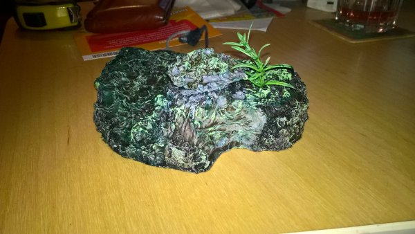

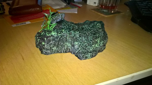

    Found some varnish that didn't come in a spraycan so it didn't melt the stuff anymore.
    The results:
