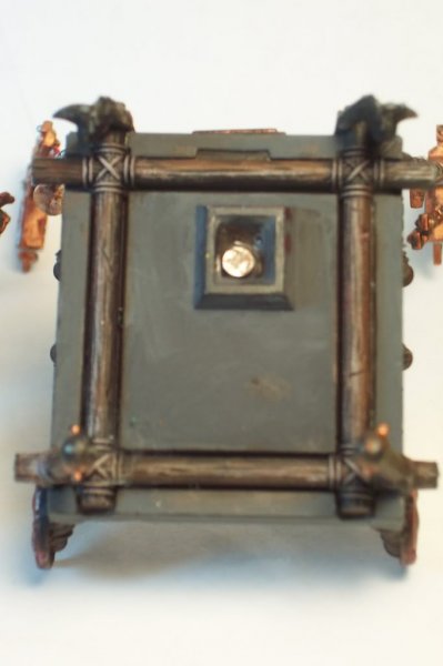

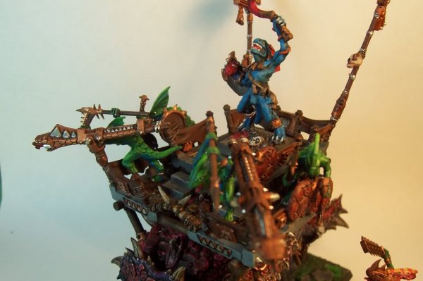

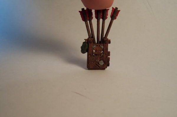

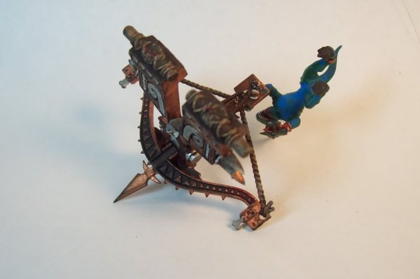

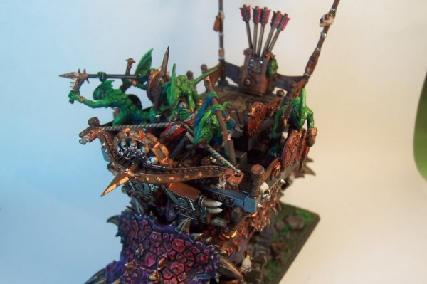

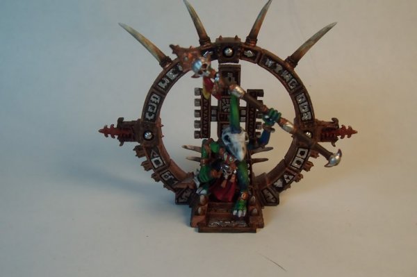

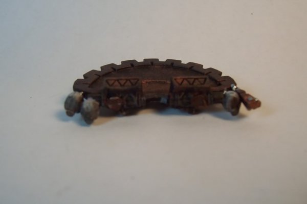

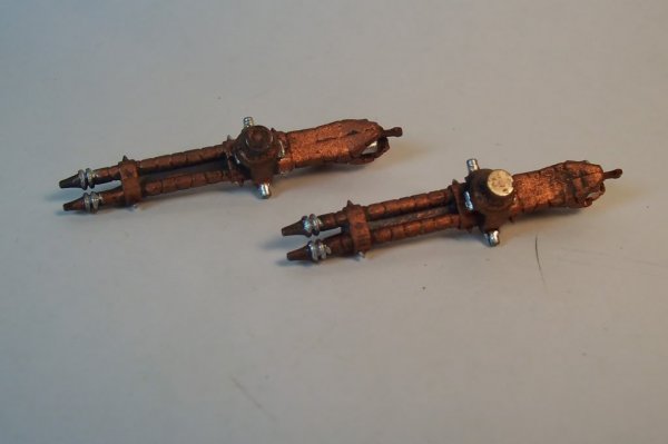

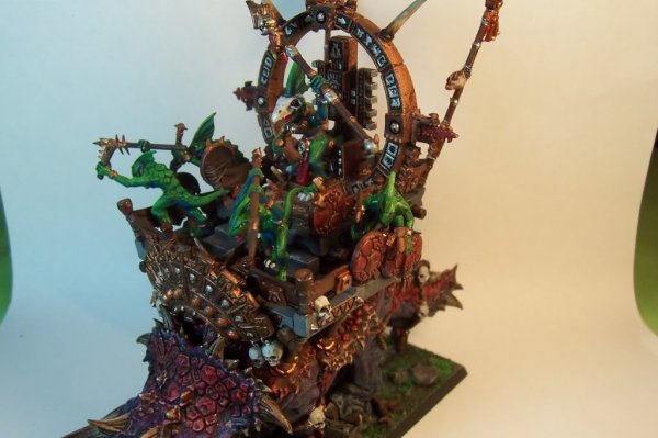

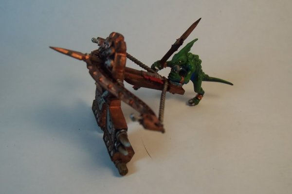

  10. n810
    6,520
    I have Sucessfully magnitized my steg for every configuration,
    so give a shout out if you have any questions or want to see pictures.
    But strewarts advise is right on track. :D
  11. msinosic
    msinosic New Member
    261
    I would love to see pictures and I think many other people here would also!
    What I would like to see most is close ups of where you have placed the magents for each part and of course what all the configurations look like in their complete magnetised glory.
  12. n810
    6,520
    Here's some close-ups of the magnetized bits...
    Seraphage, Bracnos, tom ndege and 3 others like this.

  15. n810
    6,520
    "Whoa... nice fire there!
    Yea I converted the Skink with the empire Wizard accesories
    because That flaming skull is just awesome... :meh: :jawdrop:

  17. n810
    6,520
    Oops I guess I should have mentioned I had to Expand the Howda to fit in all the Skinks....
    you can see this in one of the first pictures... :rolleyes:
    Oh I forgot to ask does anyone have any questions ?
