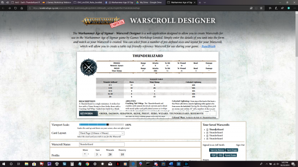

    Can someone help with this? Trying to make it bigger but for some reason it just keeps screwing up? Is there something I am doing wrong? Screenshot (989).png Screenshot (990).png
  6. Sudsinabucket
    2,172
    7,419
    Screenshot_20191025-180937_Chrome.jpg Formatting worked on my phone just fine but not on my computer....
    But there they are!!!! Wooo!!! Thanks everyone!

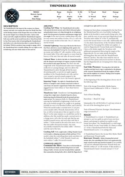

    Some suggested changes, thoughts?
    Screenshot_20191026-073259_Reddit.jpg Screenshot_20191026-073307_Reddit.jpg Screenshot_20191026-073507_Reddit.jpg Screenshot_20191026-073514_Reddit.jpg
  8. ILKAIN
    ILKAIN Well-Known Member
    1,845
    3,389
    all of the things they brought up, we brought up in design. there's nothing new there. the logic we put into it is sound. the only thing we might be off on is the pricing of the cheaper variant. might need to be 100 more. some of what they presented is just folly... 24" is 1/3 of the board, and the range on some of our damaging spells from the lore. there is no justifiable reason a healing spell that can at max heal 6 wounds should have a shorter range than a damaging spell that can inflict 8. the TL is a support unit... RNG on the stomps was intentional. we want it to do damage, but not be designed to be the most efficient damage dealer. and no... the TL isnot going to face a single beatstick threat... its going to be swarmed exactly as you said... with rend inflicting hordes. their input is valid... but again... its nothing we hadn't already discussed
