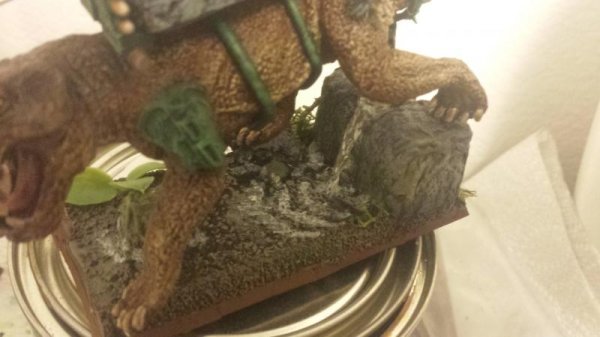

    I was asked for tips on how to use this product via mail after someone had seen and liked my carno's base.

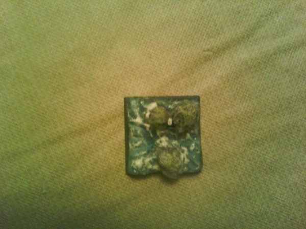

    2. Paint it. You must paint where the water is going to be with very sharp contrast. The regular dry brushing methods that normally look great, disappear when looking through even clear "realistic water". Optional, add a fine-moderate dry brush of light blue.
    Example: Hard to see. Ill try and get a better picture if anyone is really interested in this. The blue is there. Just look real hard.

    Example of water effects: Here you can see it being used in two ways. Clear just to add texture, and with paint mixed in to create ripples. Another thing I have done in the past is just used my finger. Apply the water effect directly on the realistic water and quickly dab or tap it into peaks.

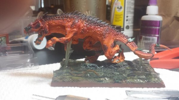

    Other methods not covered, free floating water like my carno/steg bases | painting a surface and adding water effects for a deeper/animated look | Adding paint while drying for streaky swampy water.
    If you're interested in these let me know and I'll add some tips for doing these.
    I don't have the terrain with me that I used the streaky water on. I'll try and get it soon. It looks great! But here is the "animated look".
    EX:
    Another poor picture. surprise?
