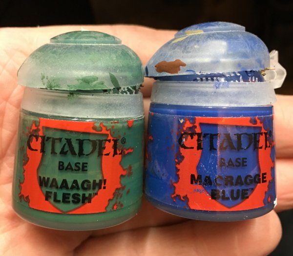

    1. (I'm using a 40mm) Paint your base green and while still wet paint on some blue, just be random and don’t worry about the look.

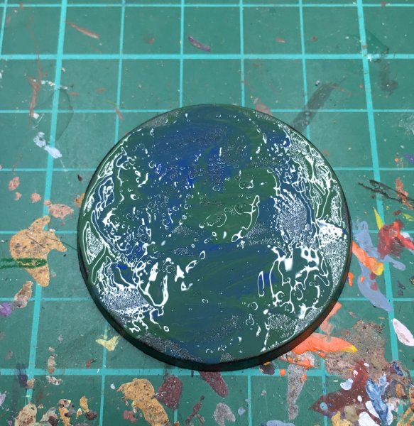

    2. Once dry apply a thin coat of your chosen water, I’m using realistic water from Woodland scenic.

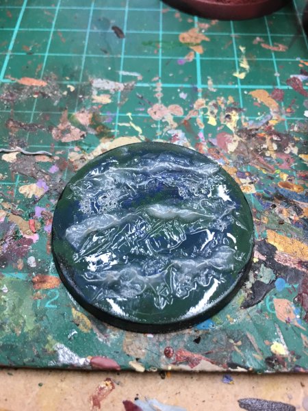

    3. Once the water effect is completely dry apply some thin lines of your water effect, this is thicker and has a consistency like pva glue, I’m using water effects by Woodland Scenic.
    Now we all know waves aren’t straight so we now take a cocktail stick and manipulate the lines, move them back and forth and flick crests into them with your trusty cocktail stick.
    When your happy with the look leave it to dry completely usually 24/48hrs, you know when it’s ready as it goes completely clear.
