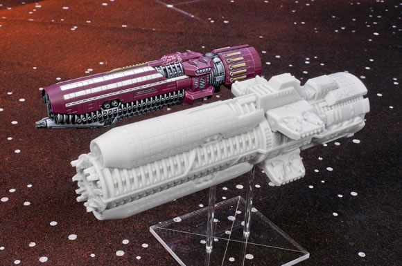

    I know that Spartan Games has moved to doing all of their modeling and prototyping to 3D/ 3D printing. The models turn out superb. Not to mention, the artists can print a model out in a day and actually get his hands on with it!
    Pic of a Sorylian battleship (Painted) and an un-painted Dreadnought. I think the Dreadnouoght is around 5-6 inches long.
