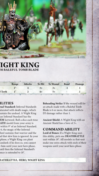

    Eh, no. I just looked up the warscroll in the app again. It clearly says: command ability: "Lord of Bones" which is exactly the same as the Vampire Lord's command ability, only for Deathrattle instead of all Death, and with more range.
  2. Aginor
    20,139
    Ah I think I found the issue!
    @Killer Angel you are using an old warscroll, probably from the compendium. The CA is missing there.
    Killer Angel and Bowser like this.
  3. Killer Angel
    15,021
    33,049
    Indeed I was!
    This makes the Wight King much more useful! :)

    The wight king actually has a command ability. +1 attack for one Deathrattle unit within 18''.
    https://www.games-workshop.com/resources/PDF/AoS_Warscrolls/aos-warscroll-wightking-en.pdf
