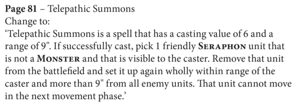

    Well, the FAQ is out, and Telepathic Summons got the expected nerf:

  11. The Sloth Bear
    The Sloth Bear New Member
    5
    2
    So does this mean we could still teleport into combat then since it's not listed as a restriction?
  12. Slikus-Vaw
    Slikus-Vaw New Member
    25
    no we cannot teleport into combat but can teleport out of combat. We have to be 9” away from enemy units
  13. Vallis
    Vallis Active Member
    125
    131
    Incidentally, the spell also now works on any
    non-monster Seraphon, not just Saurus.
