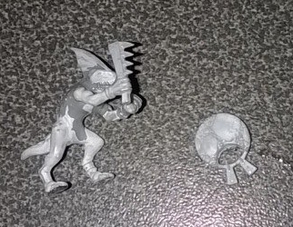

    Hello everyone, unfortunately due to my lack of understanding of how sprayed primers were to be applied I applied far too thick coat of it on the model. I wanted to test some colors on it, so I kept the model as is for some time. Recently I decided to strip it with IPA clean solution which worked on 90% of the paint (with some toothbrush scrubbing included). There are, however, parts of the model where a very thin coat of Corax White is still there and cannot go even after 3th and 4th scrubbing session.
    Is it OK to leave that thin coat and simply spray the remaining parts of the model or should I also make sure to spray-paint the already thin coated areas as well?

    This is really quirky @bOdziO Wolf . I had some Daughters of Khaine I was experimenting on a while ago, using GW white spray (can't recall name) to prime them. With the only real difference being I used a brown dettol dip for stripping, everything lifted off no problem.
    How long was the IPA solution left to soak in?

    GW white spray is actually the Corax White primer.
    Each time I gave it a full night.
    Funnily enough for the first time I was able to strip most of the paint, for the second time most of the remaining paint got off as well. Then third and fourth time yielded no visible results, BUT I also reused IPA from session 2 (this shouldn't make any difference though).

    I wish I could be of more help but it doesn't make any sense why it is so stubbornly taken to the model :(
    Taking a closer look at the picture, you would almost be forgiven for thinking that white paint was oil-based, given the sheen on it.

    I assume this is because of the amount I accidentally put on the model. Its weird indeed that I was able to trip part of the model with ease and other parts look like they are literally immune to the detergent.
