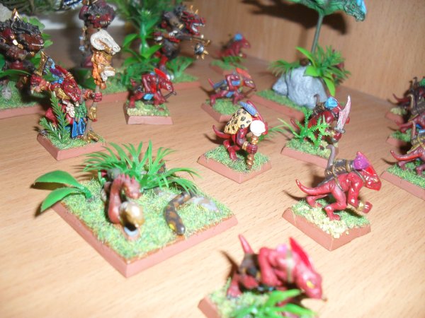

    Not sure if it was mentioned, (perhaps because it was too obvious) but if you have a spare base for them, the cavalry sprues come with some snakes. Glue a pair of those to a base, with some plants and perhaps an extra green stuff snake or two so they don't all look the same, and you have a very simple jungle swarm.
