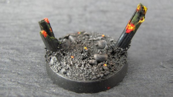

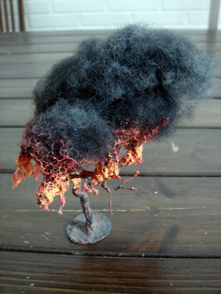

    Much easier to find stuff for "lava bases" than this for some reason. Did find a tutorial though:
    Also saw these in a random image search:
