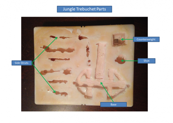

    Well I have some experience casting warhammer models, and have only just begun casting some minor scenery stuff. This includes mostly Bretonnian Knights, but also some men-at-arms bodies, peasant archers, and my jungle trebuchets. Most of my casting WIP pics are over at the Round Table.
    I have only more recently tried casting chameleon skinks and temple guard bodies (and some dragon wings!). The biggest issues I have found are air bubbles and flak lines, but for scenery that isn't as much of an issue.

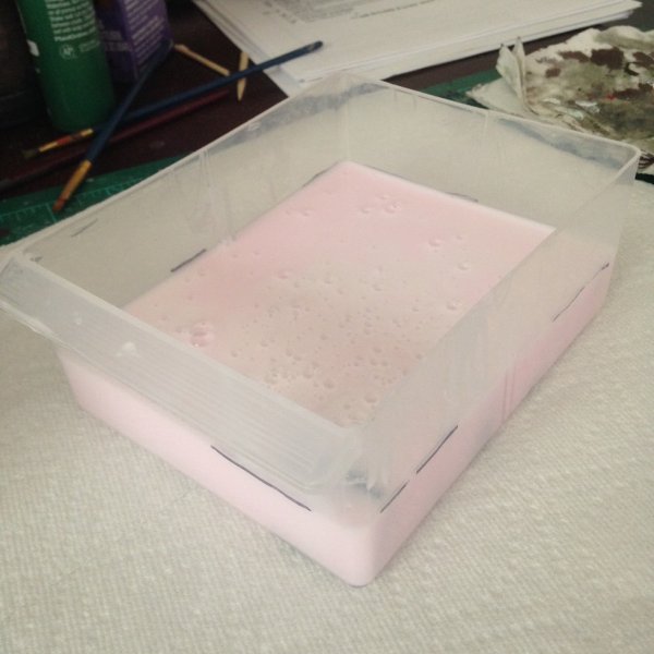

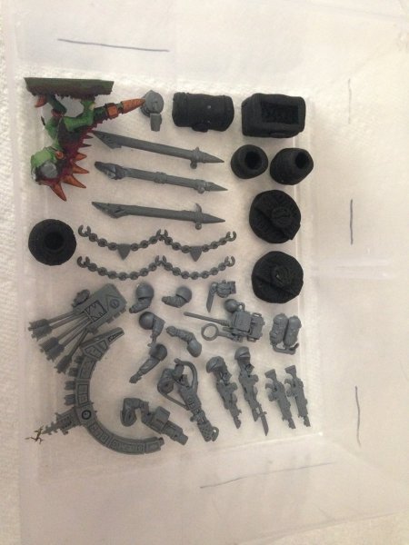

    Step 1: find a container (***THAT DOESN'T LEAK***) and glue the things you want to cast to the bottom. This prevents them from floating to the surface after you pour the mold material inside it.

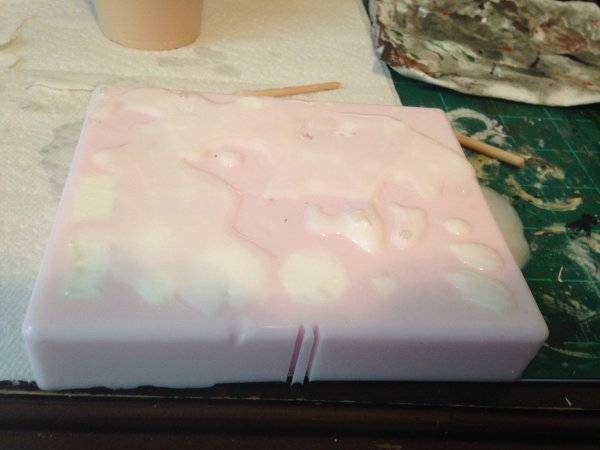

    Step 2: Follow the mixing instructions on the box to mix and pour the mold substance. Normally takes a few hours, I leave it ovenight to dry. You might need to do the math to see how much of the container will be filled. I have a line drawn on the side of my mold container so I know not to stack minis too high.
    Step 3: Next day, gently pull the minis out. It can take a while, and you may need to cut open the mold with a craft knife. But the mold is rubbery, that is what it is made for.

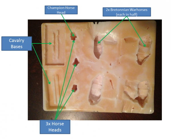

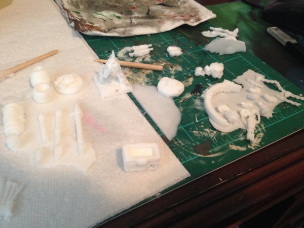

    Step 4: Mix the resin and pour. I try to leave them in for about 5-15 minutes, then pull them out before they get to hard. The larger and less tiny pieces, the better the resin cast tends to come out.

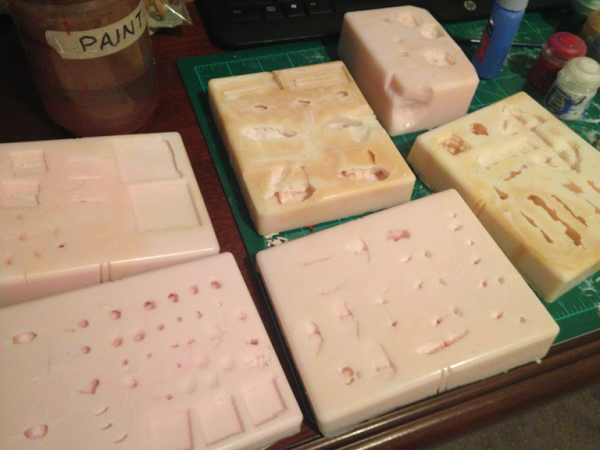

    Some more completed molds:
