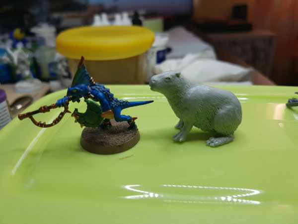

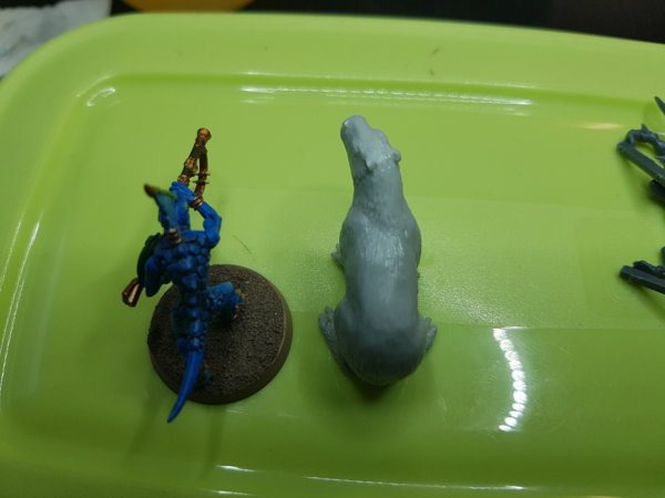

  9. Aginor
    20,146
    Here is a Skink with a Capybara.
    It looks small and I know it will probably look kinda goofy but I want to build it just for the Lulz :D
    And I will of course convert an unpainted Skink.

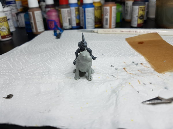

  18. Aginor
    20,146
    Ok that kinda worked.
    First draft, pose looks slightly goofy but OK. The white stuff is poster putty.
    It would even work without a saddle, but I'll have to think about it. I want to do a saddle so I can hide the places better where I mount the Skink on its Capybara. I don't want to use super glue but something removable to have the Capybara as a standalone model.

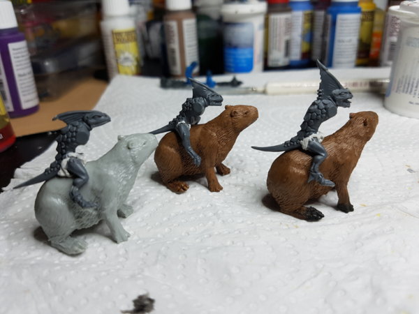

  19. Aginor
    20,146
    I'll refine them soon, but here is how they look now. A bit like something a Slann that had a few mushrooms too much dreamt up. :D
    Could work. :)
