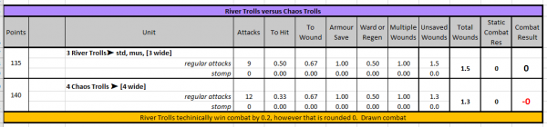

    But is it worth the point differential? River trolls cost 45 points, while regular trolls are only 35 points. That's a pretty substantial difference. 4 regular trolls cost 140 points, while 3 river trolls cost 135 points.

    I'm reluctant to add new entries to the list as the adding a single entry means 16 more matchup calculations. With our current list of 16 entrants, I already have to conduct 120 matchup calculations (some of which will involve a fair bit of complexity). Adding the River Trolls will boost the required matchups to 136!
    Towards the end we can run some separate numbers on them, but they are too similar to Chaos Trolls. Here is a head-to-head matchup
    So, in practical terms the contest is drawn. There is a microscopically greater chance that the River Trolls win the combat and break the Chaos Trolls. However, there is a greater chance that the contest comes out as a draw (as 0.2 is far more likely to come out as 0 rather than 1). If that is the case then the Chaos Trolls would win a war of attrition because they have more models/wounds. Plus the actual combat results begin to favor the Chaos Trolls as they both lose models... i.e. 2 vs. 3 and 1 vs. 2
