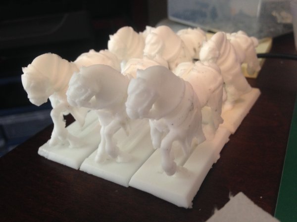

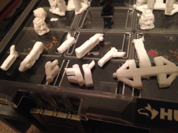

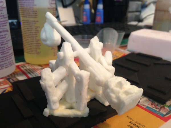

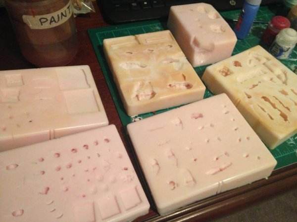

    I have never tried GS molds, or GS in general (didn't want to pay for it/scared of getting it to work). My brother has tried it a few times though I will have to ask him about the process sometime.
    I use some "relatively" cheap rubber molds that I have gotten from Hobby Lobby, but you can find them in most craft stores. "Amazing Mold Rubber," usually I find it for $20 in the store, but I got it on amazon for under $14 once. You can see the stuff I cast into a mold next to it inside the plastic bin.
    The molds wind up pink in the end. Using some "Amazing Resin" stuff from the same company I have been able to cast a bunch of things for my Bretonnians. I have been able to cast extra peasant men-at-arms, archers, and even knights and their horses to make use of all the extra head bits that come in the kits. Plus I have been working on my jungle trebuchets, which I am trying to finish painting this weekend.
    Peasants:
    Knights Horses:
    Trebuchets!
    More pictures over in my other painting blog at the Round Table of Bretonnia
    Only big issue I have with this process is that it causes a fair amount of bubbles sometimes in the cast pieces (which I either ignore or fill with self-hardening clay) and I can't seem to cast anything that is excessively pointy like spears, lances, or other weapons. But most bodies, and larger pieces work. My next mold I plan to cast my slann so I can make multiple copies... 5 SLANN IN ONE ARMY!!!
    @Bracnos I really like the idea of a reusable mold! It sounds really easy to use. It looks like your molded pieces are made of green stuff?

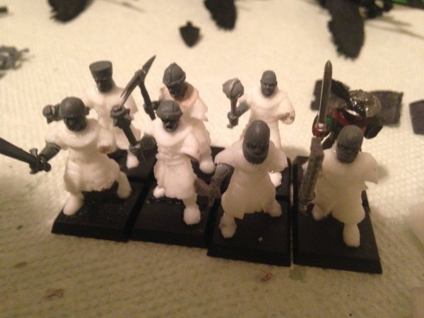

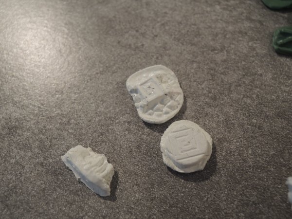

    So first casting results look ok to me, though not perfect. Theyre TG details, one skull from the drum and one bone helmet.
    All the detail isnt perfect obviously (I'll need to hollow out the bottom part of the skull to make some teeth appear, sculpt some horns on the helmet…) but eh, it's gonna help me build more units for just (loads of) time and some green stuff instead of 45 euros so what can I do… unless you guys think I shouldnt be so easily satisfied and should try making new moulds?
    (Also, I've just removed the original bits from another 11 moulds including other details such as more skulls, shield pieces, the unit leader's ornate helmet, knee pads, another helmet and animal teeth which TG use for jaw protection/adornment. I'll be trying these too shortly, whenever i get the time. If it feels alright, at long last I'll be posting pics of my TG-based host's very first unit soon, and it'll be full of green stuff hehe :D
    As usual lemme know what you think :D

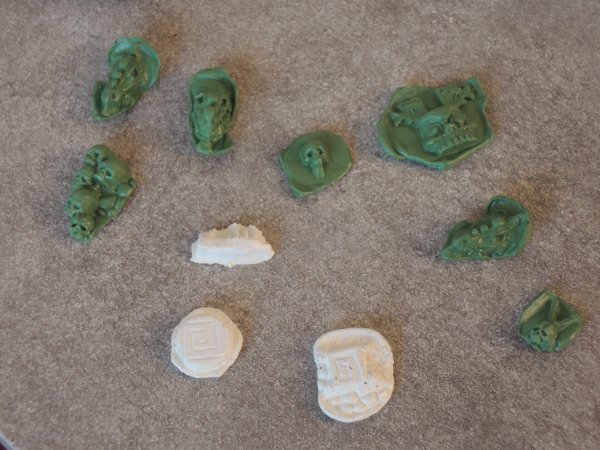

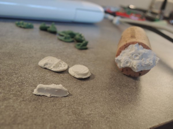

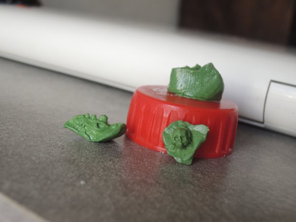

    So heres an update on my milliput/GS experiments. hope it may be useful to some of you :DNB: by milliput I mean the white, 'superfine' one. i dunno about the other varieties (terracotta, yellow etc).
    So overall, I think milli isnt best used for casting pieces in general, but it has some qualities which make it awesome for a certain kind of texture: it gives sharper results, it's more solid, and the texture is less 'round' or 'pasty' than GS…
    @Crowsfoot if your experience is different please say so, i'm a beginner here.
    Main drawbacks:
    - Milliput, when it cures, has a tendency to "absorb" liquids, including oil. Which means it sticks to the mould (when I took off the parts, the moulds were way dryer than with green stuff)
    - it becomes rigid and fragile (GS remains more flexible), which means if you pull one part of the piece too hard it may snap off (unless maybe you use a thick layer, which is less cost efficient).
    - so little, simple bits will probably work because when you remove em the pull will be more uniform, while bigger bits have to be removed little by little by progressively levering each side with the knife. On the bigger bit (pic below) the parts i pulled, being pretty thin, broke apart from the main piece.
    ==> So to me, GS seems better suited if you need to cast bigger, more complex bits: even thin layers will withstand a harder pull.
    I may be wrong though, i'll be making more experiments…
    - Maybe more oil would do?
    - Maybe i just used too thin a layer or pulled too hard…
    - Maybe if i had removed it before it cured entirely it would have been ok.
    - I havent had the time to try using the bits, maybe milliput will be easier to file, being more solid, so itd provide a better result on the model…
    - Also, with more flexible moulds (oyumaru…), i guess you could push the mould from underneath and not pull the milli. I'll probably give it a try :D
    What the features of milliput, as compared with GS, seem to allow:
    - it's more solid, so maybe edges etc can come out sharper (they often seem a little rounded with GS), and the texture feels more 'stone-like', 'bone-like'…
    - it has a tendency to crumble while GS has a tendency to get 'ripped' or 'torn' apart. It feels more like plaster… The 'crumbling' aspect allows for awesome ruin effects. If you mould or sculpt a piece and start taking bits off you'll have a nice "damaged" effect: here's an example, look at that piece on the right. i failed to take it off the mould in one piece but now it looks pretty good i think…
    So yeah, don't hesitate to tell me what you think and also, please let me know if you're interested or not in more postings on moulding/casting, I'm getting very excited and interested but you guys may find it boring :sorry:
    Anyway, heres a pic of the pieces i cast! GS stuff is still not perfect but it's a good start. The milli parts i did pull off are good too :) More to come over the next few days. of course comments, thoughts, criticisms, ideas suggestions (…) are more than welcome :D

    The milliput I used is the yellow one which dries hard like greenstuff, have not used it for years but I bought some when I started back as greenstuff was not common then.
    Castings look great and I can't wait to finish all my side projects to get onto my Temple and start making bits.
